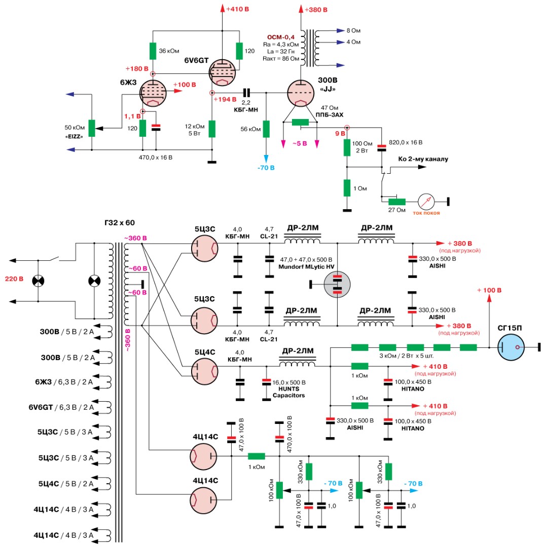

ось, знайшов самі найперші заміри, коли макет лежав на столі. без РГ. на вході 0.2В
вихідні лампи совкові, правда підібрані в пари.
на вході 12ay7 Genalex.
зараз троха інша конфігурація, замірів немає, буде змога їх зробить, обовязково зроблю.

В продолжение обсуждения питания ламповых усилителей - цитата из статьи
Marzio C., Jelasi C. Direct Coupled Single Ended Amplifier. Sound Practices. 1994; Vol. 2, issue 5.
"Plate Supply
The plate supply we installed has a transformer with a single secondary with several taps to allow for a choice of output voltages to meet the B+ requirements of various final tubes. The alternating current is rectified through a full wave vacuum tube rectifier. Our preference for rectifiers is the 83, a directly heated mercury vapor double diode, but nothing prohibits you from using other types of rectifiers such as GZ33, GZ34, GZ37, 5R4GY, AZ50, etc. The listening results obviously differ a little according to the rectifier tube used. The ideal filter would be made up of a two-section "pi" filter, which would result in an insignificant level of residual noise from the supply. The components in the dotted box on the schematic are for the optional second section. Even with a single section pi filter you will obtain excellent listening results. Opinions over the sonic delivery of the GZ34 are extremely varied. The wellknown journalist Jean Hiraga (editor of "La Nouvelle Revue du Son" and managing editor of "L'Audiophile"), for example, considers its sound coarse and lacking in detail; in contrast, the authoritative Joe Roberts considers this tube, at least the Mullard version, to have a resounding musicality. We must frankly say we are not enthusiastic about it and we consider all the other rectifier tubes mentioned and other similar ones decidedly superior. In any case, with so much difference in opinion the last word must await your own ears; when you have a chance do some comparative listening. A final improvement could be obtained by using dedicated rectifiers and separate filters for each stage: this would offer a lower common impedance and therefore less coupling between stages. At present, one of the authors is using this arrangement. We are not providing a schematic with this type of dual supply arrangement, but we may do so in a future issue if there is sufficient interest from our readers. Surely in this case the already considerable size of this amplifier would increase."
Перевод фрагментов цитаты:
"... Среди выпрямителей мы отдаепм предпочтение лампе типа 83 - ртутному двойному диоду (газотрону - комментарий LinuxManiac) с прямым накалом, но ничто не мешает вам использовать другие типы выпрямителей, такие как GZ33, GZ34, GZ37, 5R4GY, AZ50 и т. д...
В любом случае, при ... большом различии мнений последнее слово должно остаться за вашими собственными ушами; когда у вас будет возможность провести сравнительное прослушивание...
Окончательное улучшение может быть достигнуто путем использования выделенных выпрямителей и отдельных фильтров для каждого каскада: это обеспечит более низкий общий импеданс и, следовательно, меньшую связь между каскадами. В настоящее время один из авторов использует эту схему..."
Конец цитаты.
На основании этих сведений, а также сведений из прочих источников, которые были проверены в собственных конструкциях, я (при возможности и не всегда) применяю раздельное питание каналов и каскадов усилителей, при этом использую как кенотроны, так и газотроны, и тиратроны.
Если имеются противоположные мнения, то предлагаю сообщить о них здесь с указанием источника (руководство, монография, журнал и т.д.).
Если автор темы сочтет это сообщение здесь неуместным, то оно будет перенесено в новую тему.
